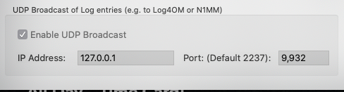

I set the SmartSDR for Mac logbook to output to 127.0.0.1:9932 so that I could monitor the output with udp_listener from Don (VE3VRW). 9932 is the only port that udp_listener listens to, although SmartSDR's logbook defaults to 2237.
Here is a snapshot of the settings:

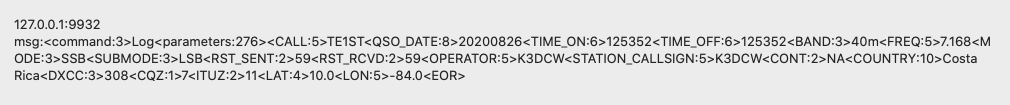

I then did two test logs and udp_listener reported the following command/format (sorry for the picture, but udp_listener doesn't provide a text output). It looks like basic ADIF format with a simple command structure. I also did a test by deleting a log from the SmartSDR logbook, but it did not produce any output, so I think we're looking at a logging function only.
I hope that this is useful. If you need any more info from me, simply let me know and I'll get what I can.

This is not the N1MM format! I could get it working, but you should ask the developer for the message specification.
