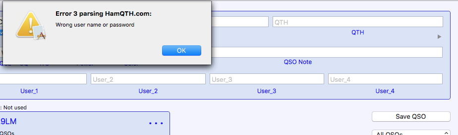

I was on the verge of posting a new topic yesterday, but I kept searching the forum for HamQth issues. I verified all the settings as noted from other post topics, but every time I tried to tab beyond the CALLSIGN box, I received an error (see attached screenshot) regarding HamQTH.com. I reset the pw several times on HamQTH.com and verified it worked for the website, but nothing changed with RumLogNG until I recalled a comment from a code writer in my office. I had the "&" character in all of my PW settings at HamQTH.com. When I removed the "&" from the password, the error no longer appeared and the appropriate data now filled the log fields as desired.
So, Mr. Tom, I thought I would share that experience so that you and/or others like me might benefit. Could it also be that other special characters might create similar parsing issues & impede the callsign query process?
