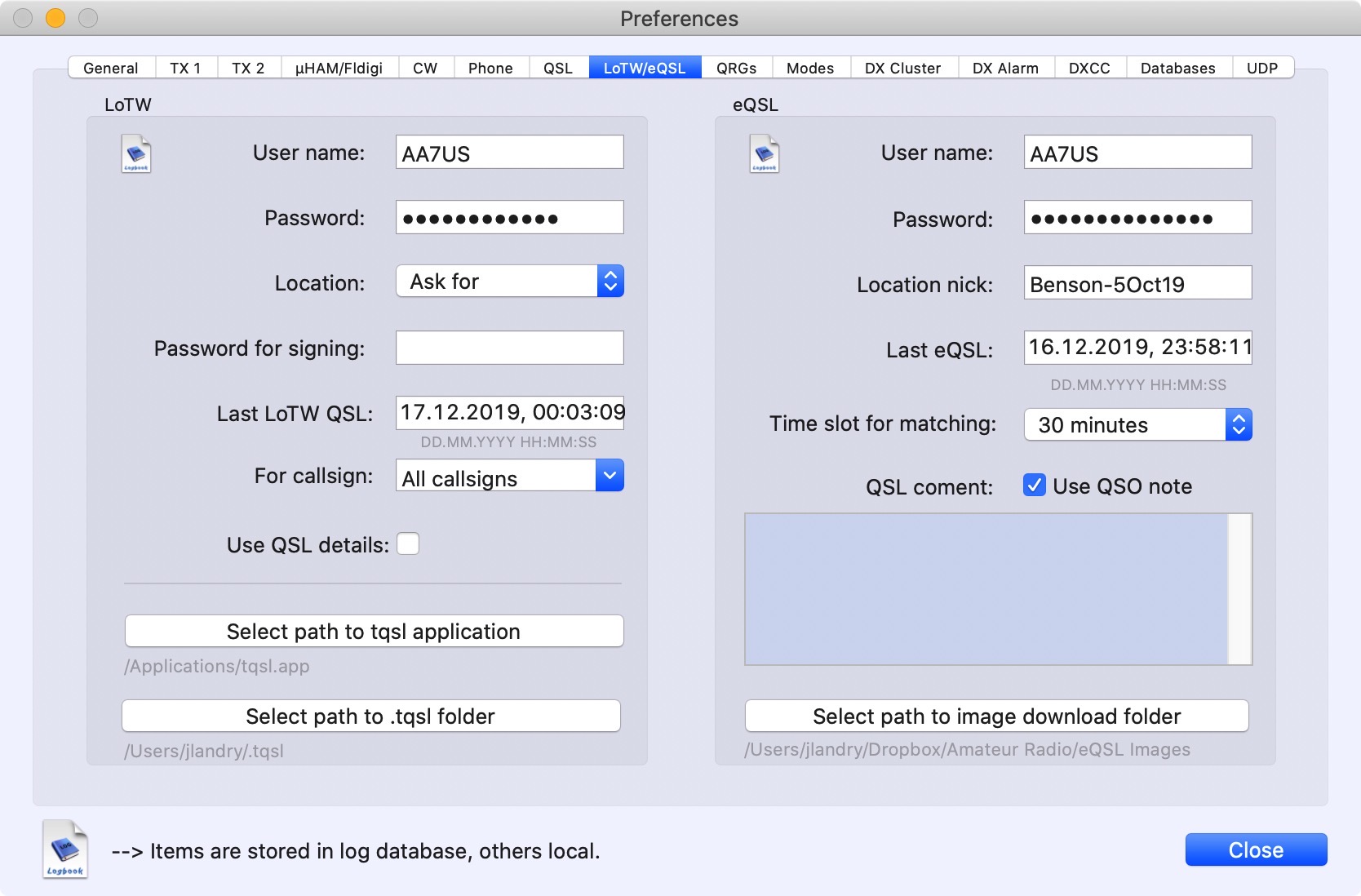

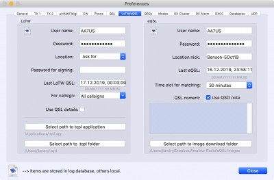

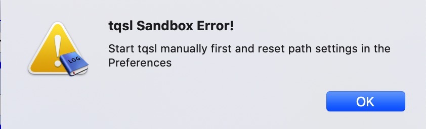

Pse post a screen shot of your LoTW setting tab and from the full error message.

As requested, the LoTW settings screen and the full error message are attached.
Please note that LoTW downloads (menu item "QSL -> LoTW in") works fine.

In the past, it seems like every time I updated tqsl I'd encounter the sandbox error again.
This is as expected and by design.

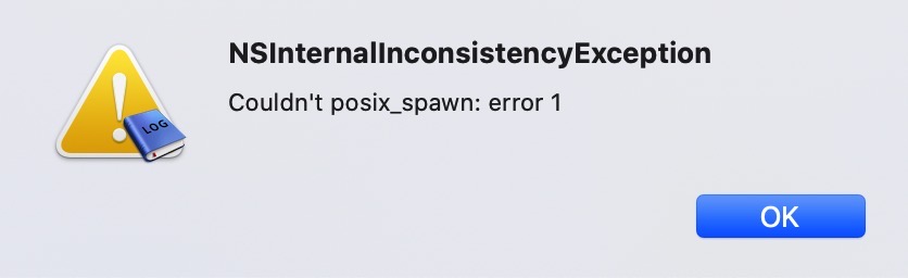

Your settings are looking good and I have no idea yet. Please try this version: https://dl2rum.de/RUMlogNG/RUMlogNG_Test.zip
I added a second error box, maybe this helps us a bit more to understand the problem.

OK Tom,
I deleted RUMlogNG and installed RUMlogNG_Test.
After clearing the usual sandbox error popup, there was a second popup beneath which showed this:
I look forward to your suggestions.

Sorry, still no idea. What happens when you log in as admin?
