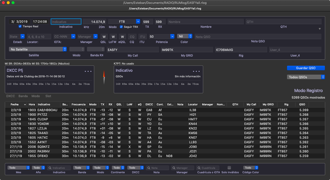

Thomas, great. Just tested it an it works as expected. No dupes on LoTW.
BTW, is there a minor bug in version 4.1 (308) The name of the program appears to $(PRODUCT_NAME).
Or is it a problem on my side?

EA5FY
Posts: 3130
Re: LoTW QSL setting change
This is just a failure in the Spanish translation.
You can set your system to English, start RUMlog and set it back to Spanish.
