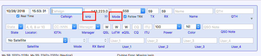

See to the logging fields in the logging window. In which colours are kHz and Mode written?

Posts: 2960
Re: RUMlogNG for Yaesu FT DX 1200?
Check again the text colour for the kHz and Mode label. In your last screen shot it is shown in blue, it should be red or green when you have configured CAT.
