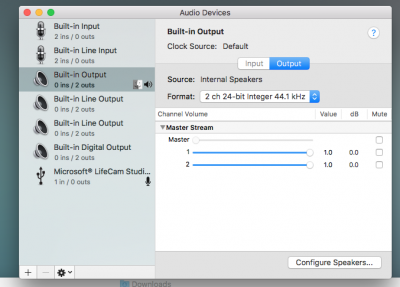

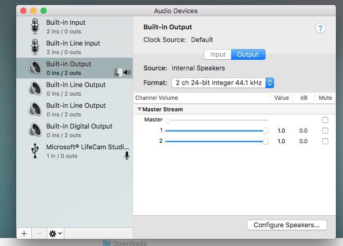

Tnx, this crash report works for me. It is your sound card! Can you send me a screen shot of your Audio MIDI Setup device window?
I will contact Chen, W7AY for assistance. The problems seems to be in his Audio Library.

This is a hackintosh by the way. RumlogNG used to work just fine until recently, don't know what changed. Maybe I have devices plugged into different ports, I don't know. I unplugged all my usb devices and it still crashes.
EDIT: I realized I had not unplugged my webcam yet.... unplugged that and wouldn't you know, the preferences opened up! I think its fixed now... Now if only I can restore my app settings from time machine...

I guess the Trademark sign in Microsoft cause the crash. I will check.
