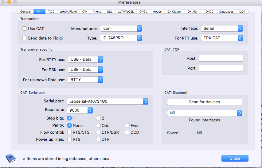

DL2RUM wrote:Can you provide a screen shot of the trx setting pane please?

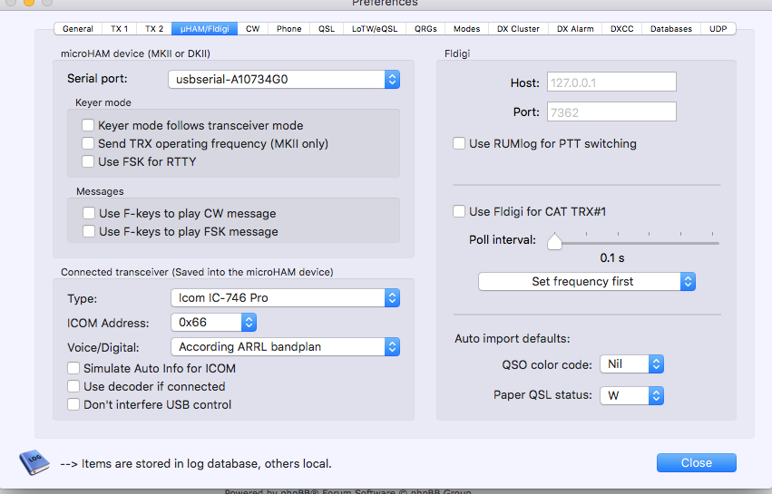

You have to enable the option “Use CAT”.
Why do you have selected a serial port in the microHAM settings? Do you use a MKII or DKII?

OK, I put a checkmark on Use CAT, and I removed the serial port in the microHAM settings. Will see how it works now.
