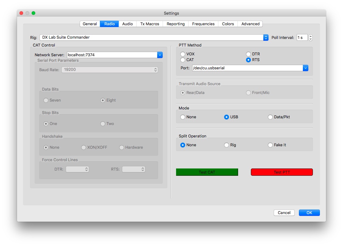

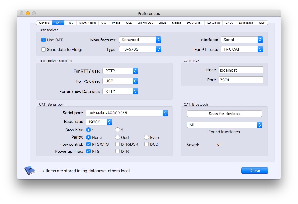

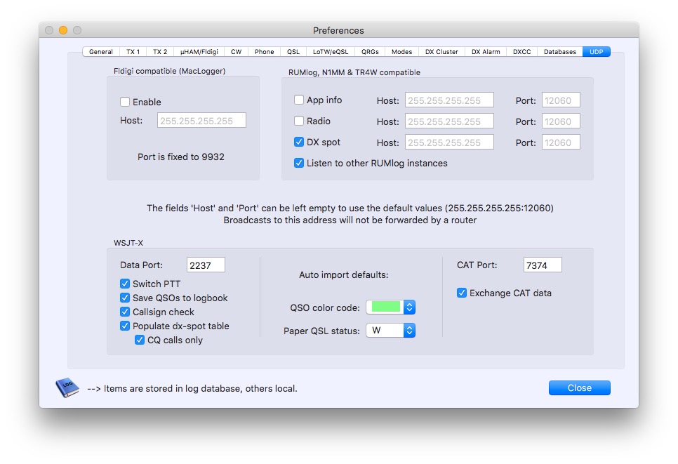

Pse post a screen shot of your RL TRX and UDP settings and from WSJT-X the Radio settings.

Of course, no probs. Thanks so much for helping me on this.

Hope these are the images you wanted to see. The image from WSJT-X shows TEST PTT as red becasue as I took the screenshot, WSJT-X was transmitting on FT8 :D

  • You have set two options for PTT: in WSJT-X and in RUMlog. You should use one option only.
  • You have set Power up line RTS. This will disable the RTS flow control.
  • In WSJT you should select Fake it for Split operation. This is not the problem, but strongly recommended.
I use a serial device connected to the RS232 port on the Kenwood for CAT control from the rig to Mac, and that uses CAT to control the PTT. WSJT-X uses a separate cable (from a different port) specifically for the Kenwood 570D, which takes the audio and mic from the Kenwood out to two 3.5mm connectors, and also uses a USB device to control PTT - hence CAT for PTT in RUMlogNG and RTS for PTT in WSJTX.
I had to use this because the Kenwood was using the microphone for the source audio in WSJT-X and there was no way to change that.
Not sure what to do here?
OK, again, not sure what I should do here. I use this for the reason mentioned above in 1st point.
OK, I shall amend that setting.

Disable PTT in WSJt-X or in RL Preferences-->UDP-->WSJT-X--Switch PTT
Disable the option Power up RTS line.

I can't see an option to disable PTT in WSJT-X, but I have now disabled PTT in RL.
Still no joy on the band change drop down in WSJT-X though! When I select an alternate band,it displays the band in WSJT-X for a second, nothing happens on the rig, then WSJT-X drop down reverts to where it was before.

The split setting is in the r/h upper corner of the Radio panel.
