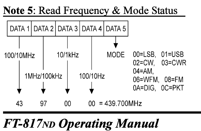

i have found the problem. It is a seemingly undocumented 'feature' of the FT817ND (maybe FT817 and FT818?? too). I have the Yaesu CW narrow filter (YF-122CN) fitted. If it is OFF, P1 = 02 for CW, P1 = 03 for CWR and P1=0A for DIGI. This is what is documented in the CAT chapter of the manual. HOWEVER, if the CW narrow filter is ON, then P1=82 for CW, P1=83 for CWR and P1=8A for DIGI. The reason I saw this only on 40m is because this was the only band where I had the narrow filter enabled.

Tnx for the hint Kemuel, good observation. How do you have found it out? With my Spy app?
See attached what I have used.
From the manual
From the manual

Yes, your spy app was key. Looking at the hex data, it was obvious that the issue was what was being sent by the radio. The DATA 5 byte (Parameter 1 for Op Mode) was consistently 8X rather than 0X for CW modes for 40m (thought it was my eyesight at first!). Since only 40m was affected, it was then a matter of finding out what was different in the radio settings. The manual provided no help as it only had the table you have shown and the limited P1 values for the various modes. A search online found someone else who had CAT issues with the CW filter installed and enabled. I turned off the filter in 40m and your spy app now reported 0X. I checked other bands, enabling and disabling the filter and found the same change in response.
