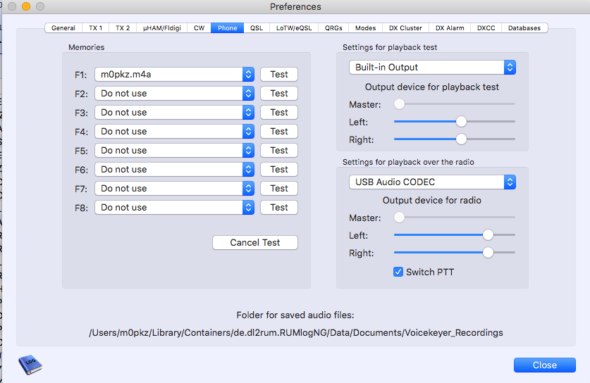

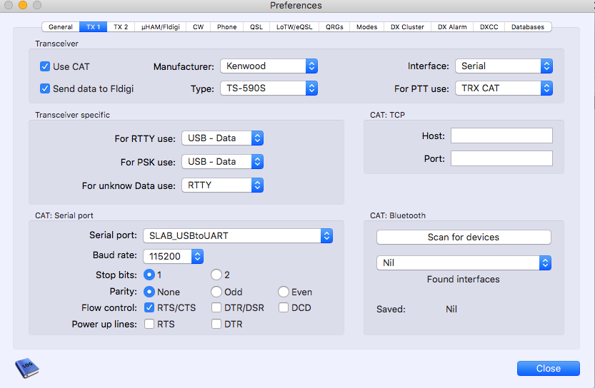

So once again settings on my mac and radio:
On radio menu following settings:
64-9
65-4
68-off
69-ON (Vox operation with data)
Also got all the time VOX turned on, but vox set to 0.
Hope this helps!!!!
Regards, Kes-m0pkz

But if you have this setting checked, why do you still use Vox for data?
In any case, i still don't have it working and i have no idea where to look for next... :(
