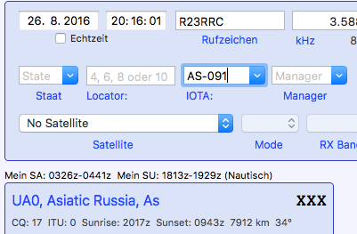

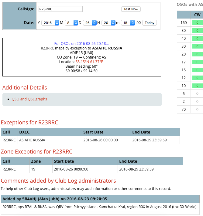

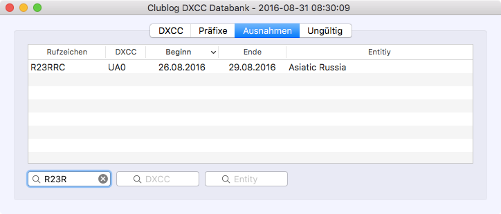

I don't see a problem with R23RRC. Where is it located?
RUMlog shows the same data like Clublog. See attached screen shots. Please note, RUMlog don't use the cq zone from the exception table. At the time I implemented this, these data were not reliable. Not sure, if it correct now.
