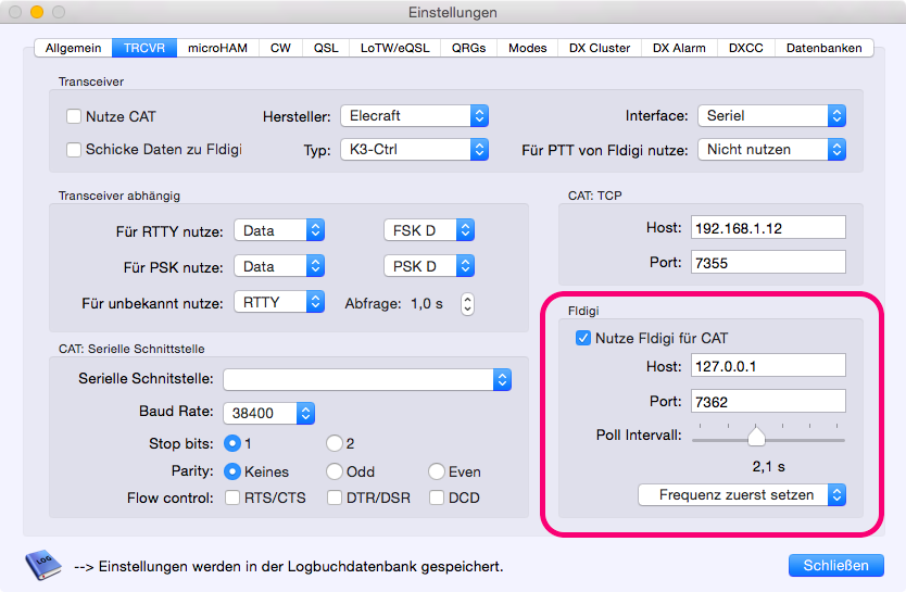

Can you try to connect the TRX to Fldigi? You have to swap both Fldigi related CAT check boxes
Good trick: tcpdump -nnvi lo0 port 7362 but don't work here. What I have to do?
tcpdump: lo0: You don't have permission to capture on that device
((cannot open BPF device) /dev/bpf0: Permission denied)
MBA13:~ dl2rum$

DL2RUM wrote:Can you try to connect the TRX to Fldigi? You have to swap both Fldigi related CAT check boxes
What is odd is that with RUMlog fldigi follows the VFO. This only happens with RUMlogNG. :(
MBA13:~ dl2rum$
run that with sudo.

What happens, when you disable all the TRX CAT and uses Fldigi for CAT? You don't to set up Fldigi for CAT, frequency exchange should work in both directions.

This did not work with RUMlogNG. I am out of ideas :(

Can you check the Console for messages from RUMlogNG?

Don't hate me for this but I moved RUMlogNG and Fldigi to a different computer and all is working perfectly. New computer is running 10.10.x where old computer is running 10.9.x.
Go figure. Thank you for the rapid response and guidance.
-Ron
Posts: 3112
Re: RUMlogNG - Updates
It should work on 10.9 as well. Can't test it, maybe someone else can confirm this.
