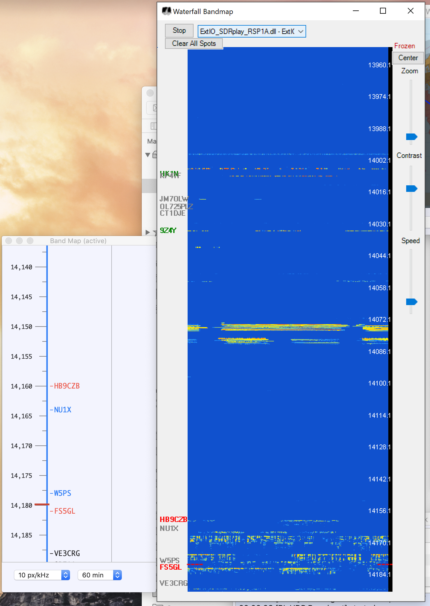

In following scenario, NU1X and W5PS are blue on RumLog bandmap (I need the slot, never worked), but grey on Waterfall Bandmap

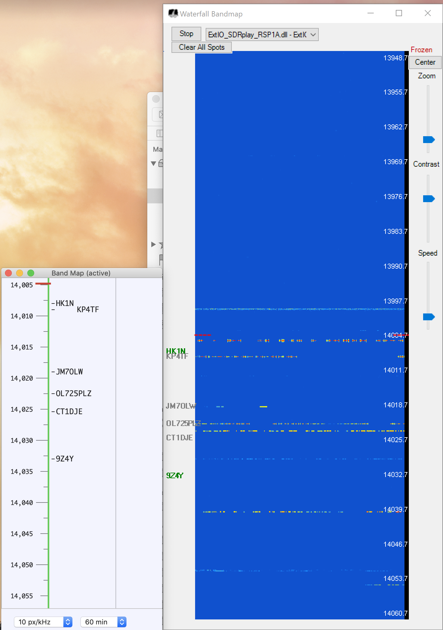

In following scenario, HK1N and 9Z4Y are black on RumLog bandmap, but green on Waterfall Bandmap. I do have QSOs with them on same band and mode, so this time Waterfall is correct on this? At least it's not consistent with RumLog bandmap.

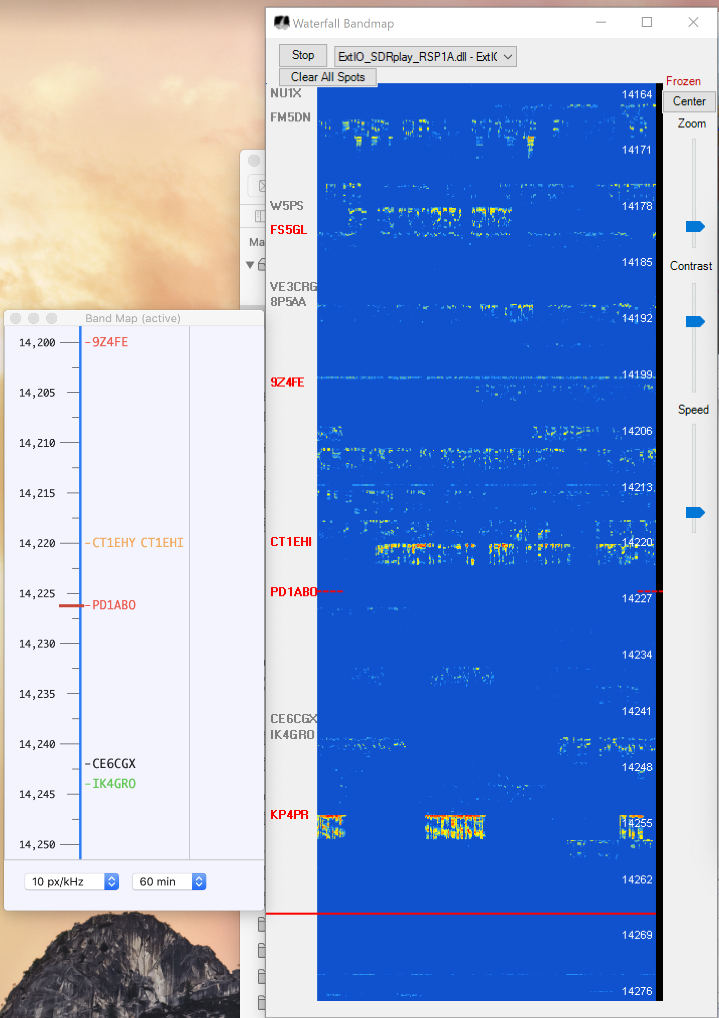

In following scenario, IK4GRO is green on RumLog bandmap (I worked this slot but didn't get LoTW or QSL), but grey on Waterfall bandmap.
