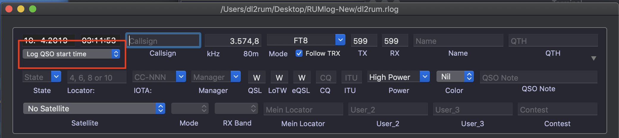

N2TSQ
Posts: 26
Joined: Thu 26. Feb 2015, 03:09
Re: RUMlogNG version 4.2
Unread post by N2TSQ »
Thank you for the screen shot, now it makes perfect sense and it works! I have a few other things I hope you can help clarify. Here the next one: Under the Add Data feature, HamQTH works fine, but for QRZ.com, I get the following error.. " Invalid user state: email_confirm ". I'm not sure how to fix this. Any thoughts?

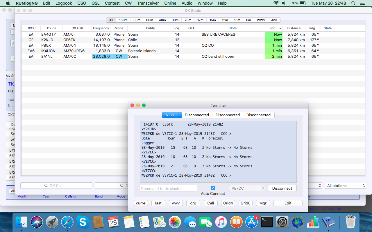

After upgrading to 4.2, I am no longer able to click on a spot frequency in the ALL tab of the DX Spots window for a particular spot in order to QSY to that frequency. However, if I select a tab other than ALL, i.e. 20M, then I am able to click a particular spot frequency to QSY.
Is this an intentional change?
Ron WB2PKR
Definitely not!
But I can't confirm this failure. Anybody else here?
Are you talking about a 'normal' dx-spot coming from the dx-cluster?

Yes, normal DX Cluster in the DX Spots window. I have always used the ALL tab.
For example, in the attached screenshot, I used to be able to double click on 28,028 to QSY for the AM70C spot.
No longer works. I need to go to the 10M tab in this case and double click 28,028 to QSY.
Very strange.
