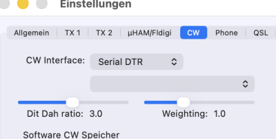

Thanks,
I tried the Serial DTR setting and then selecting the USB port for the QMX but there is no keying on the transceiver with this setup. Rumlog shows that it's keying but there is nothing happening on the transceiver. It "works" when I select TS-480 and the "transceiver" setting albeit with strange word spacings. Sometimes the spacing now is very very long :)
