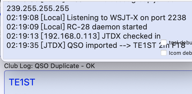

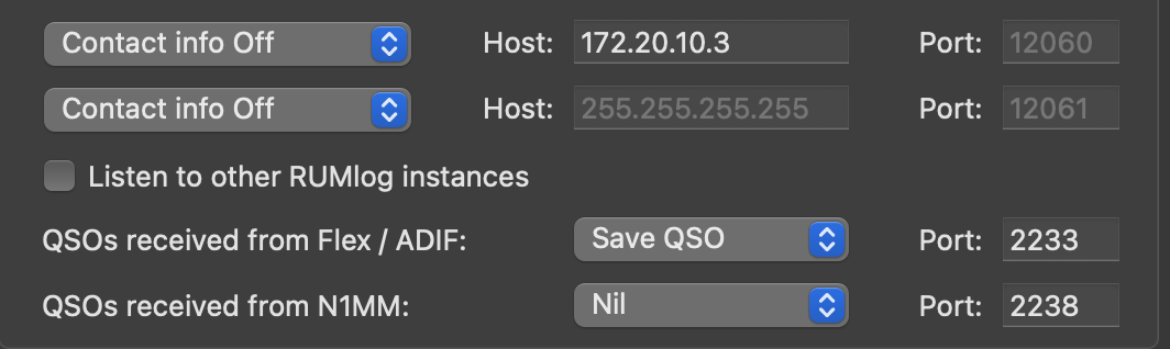

Oh sorry, I mean that one "QSOs received from Flex/ADIF".
When I use JTDX log a QSO, the one imported from WSJT-X format is uploaded to Clublog in realtime, but that from ADIF format isn’t.

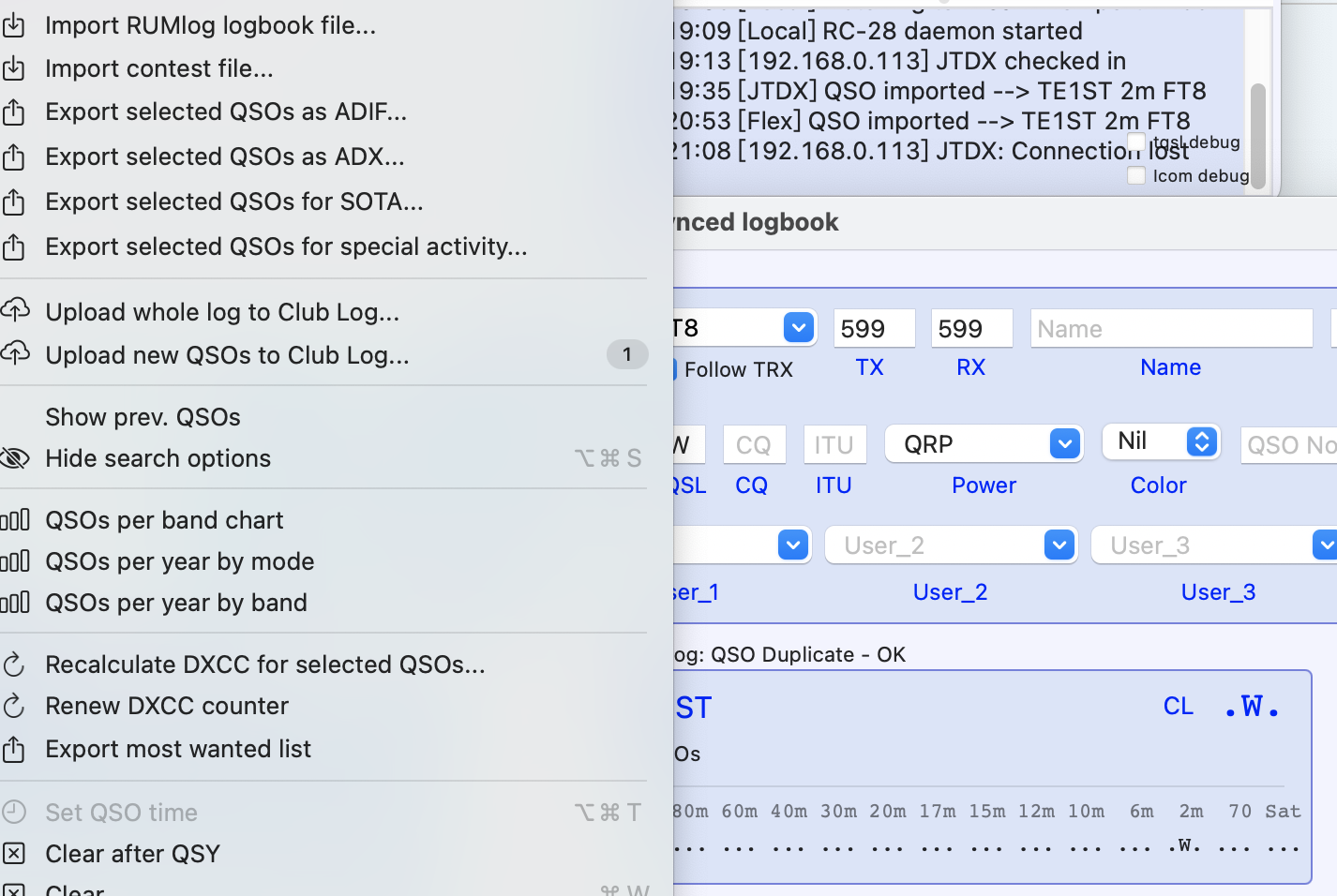

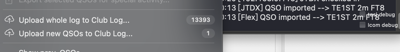

Thanks, I have already checked it. When JTDX send the WSJT-X format message all things go well. It says "Club Log: QSO Duplicate - OK". But when I only use the ADIF format, the Club Log status remain the message before.
And I can see the back of "logbook -> upload new QSOs to Club log" telling me that there's a QSO not uploaded yet.

Today I was able to test it and I can confirm the problem. The problem was a bit complex and the error was easy to overlook. It will be fixed in the next update.
Tnx for the hint.
