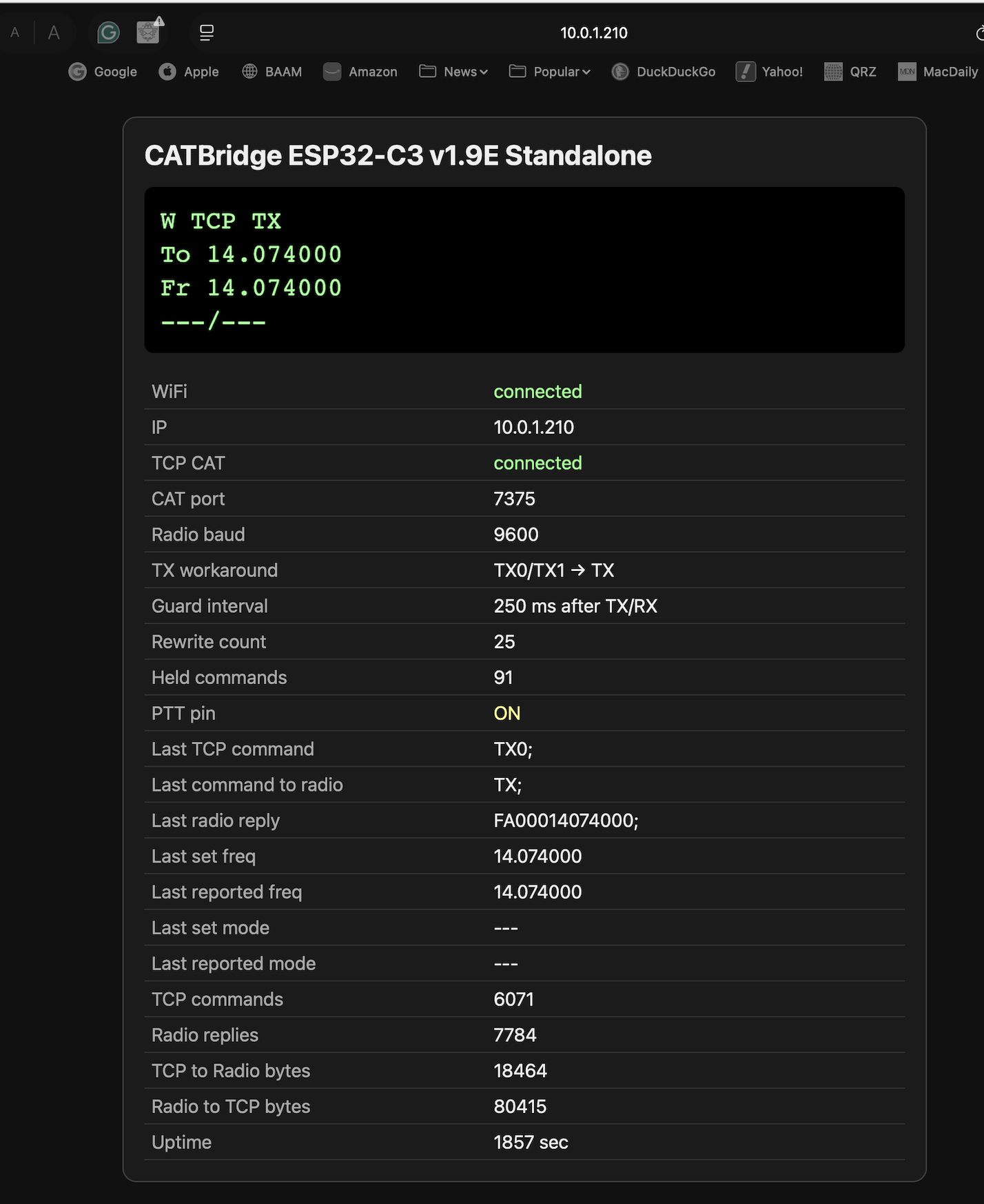

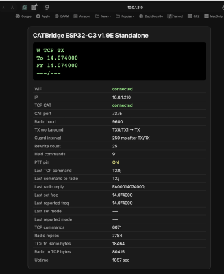

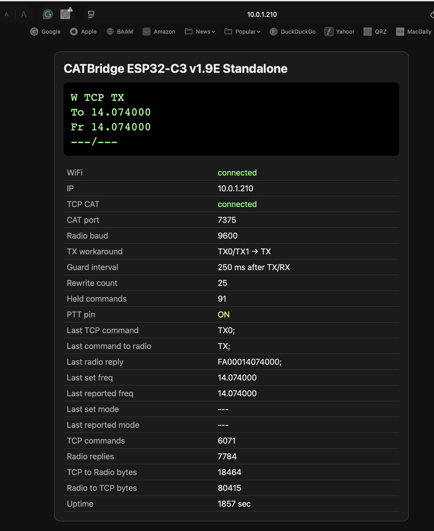

Tom:
I have discovered that "TX0;" does not work with the TS-2000. However, the abbreviated command, "TX;", does key the main transmitter. On the TS-480, "TX;" is a valid command that is read by the radio as "TX0;".
The TS-2000 manual does not list "TX;" as a valid CAT command. This looks like a firmware bug. "RX;" is rejected unless the radio is already in TX mode.
"TX1;" also does not seem to work.
I wrote a helper that intercepts "TX0;" from RUMLOG and substitutes "TX;" going to the radio over TCP serial. Now the main transmitter seems to key as it should using TRX CAT.
"TX;" might only accept audio from the microphone jack, as it does on the TS-480. I have not tested that.
Jim
WB0KWJ
This is my web monitor screen to see CAT activity. The traffic from RUMLOG is very fast, and the web updates are slow, so not everything is always visible. But I can usually catch "TX0;" coming from RUMLOG. My app, which runs on an ESP32C3 in line with the serial stream, substitutes the command "TX;" when it sees "TX0;".
