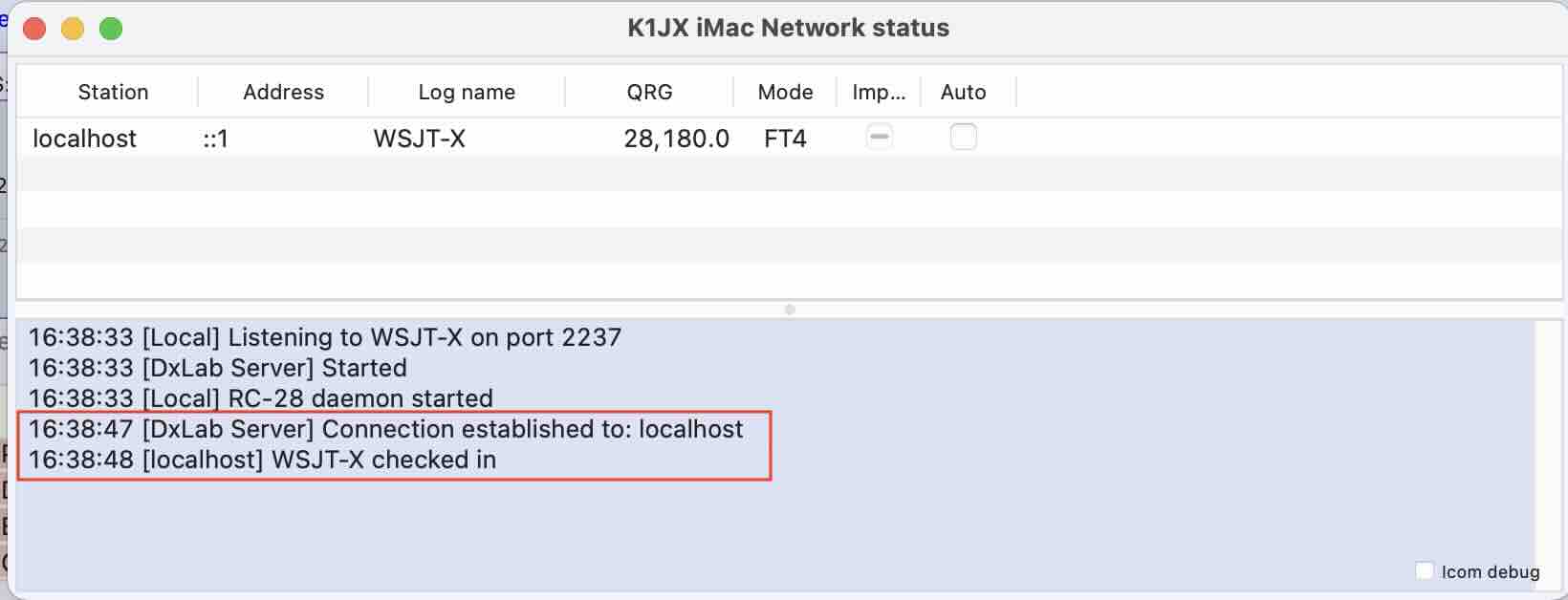

This is what the Network Status looks like with 5.2:
The responses within the red box don't take place with version 6.0.
