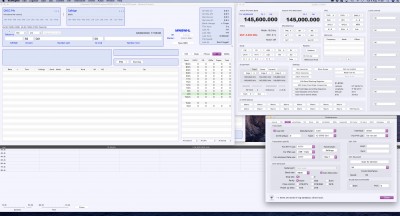

DL2RUM wrote: Tue 4. Aug 2020, 16:48 Pse post a screen shot of the window.
Here you go Tom...
Posts: 2784
Re: IC-9700 - can't get freq in contest window + more
Oh, I want to see the Scope window.
With 9600 baud it will not work satisfactory. You have to use the highest available speed!

DL2RUM wrote: Tue 4. Aug 2020, 17:06 Oh, I want to see the Scoope window.
OK, I will change the baud rate no probs, but the scope window is there!

DL2RUM wrote: Tue 4. Aug 2020, 17:06 Oh, I want to see the Scope window.
Awesome... changed to 115200 and the scope / waterfall now works perfectly Tom.
