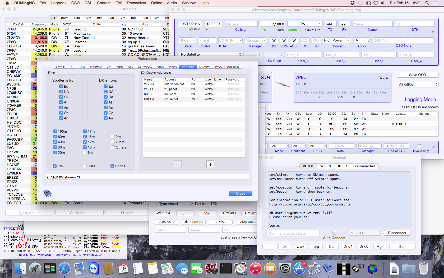

Here is a screenshot of my preferences for the terminal connections as well as the terminal window.
As you can see, the VE7CC is waiting for me to type in my callsign. If I dont type in my callsign, eventually it times out and disconnects.
This doesnt happen with W3LPL and K3LR. As you can see, they are both logged in.

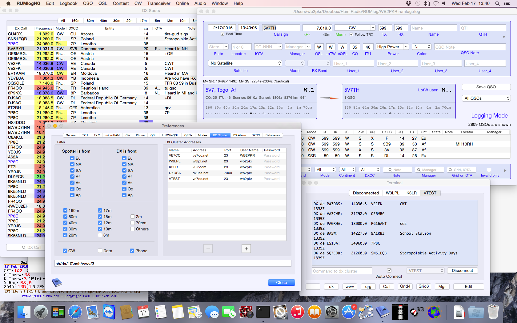

Good idea Dave. However, as you can see in the attached screenshot, no luck.
However, this morning I decided to add another source to the DX Cluster Preferences.
As you can see, VTEST, which is also VE7CC, auto connects.
Very strange. I subsequently moved the VTEST to the first location in the list and it did NOT auto connect.
I moved it to the other locations (2nd,3rd location) and it connected. There must be something about it being the first one in the list.
Followup question: In the DX Spots window, is there a way to determine what cluster source a particular spot came from?
