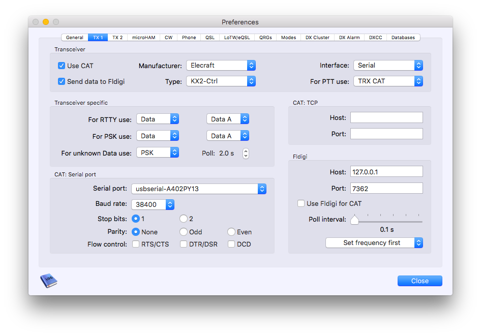

Setup TX1 with Use Cat, Send Data to FlDIGI and the FlDIGI IP/port set (see screenshot attached of the TX1 setting)

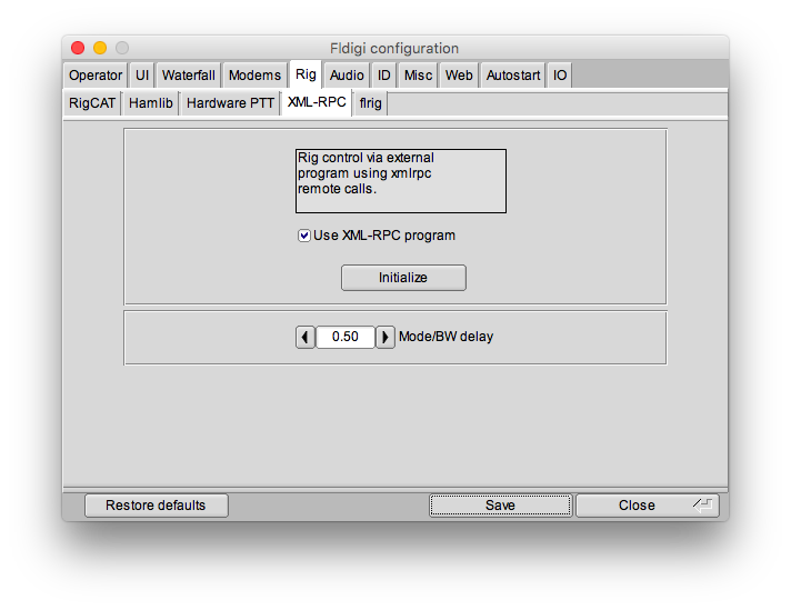

Setup FlDIGI Rig Control to use XML-RPC (see second screenshot below of the setting dialog box)

In the TX1 meeting there is the curious drop down labelled "For PTT Use", i have tried all the values in the drop down with no difference. The manual does not document what this is -- What is it??
Any help much appreciated.

FlDIGI Rig Control Dialog
RumlogNG TX1 settings

You settings are looking good, even the PTT selection. Can you check Console for RUMlog related error messages?

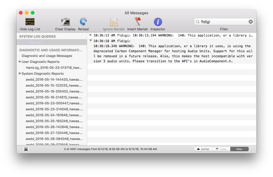

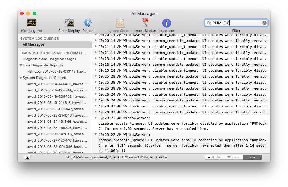

I looked through Console and could not find anything significant. There is one message for RUMLogNG that repeats (see screenshot) and 1 message for Fldigi that also repeats (see screenshot), other than that i could not see find any other messages in Console.

Fldigi console messages
RUMLogNG console messages
