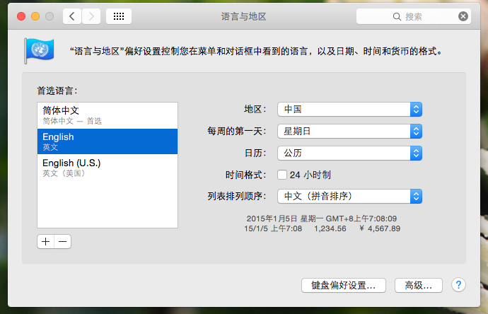

BG5EEF
Joined: Sun 15. Mar 2015, 00:32
Re: k3/kx3 macros
Unread post by BG5EEF »
Just pull the English up to the first row,and set the Reigon as an english zone,restart,you can switch back.
But now,whether I switch between chinese and English,those macros work well.It amaze me,same as the wrong display language of Rumlog and be solved after reinstalling OSX.
