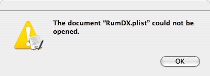

Last night I wasn't able to do much poking around with RUMped, however I am not sure if this proves anything, but I notice that Property List Editor can't open RumDX.plist. It shows the following error, but if I check the file I don't see any obvious problems with the file.
The document "RumDX.plist" could not be opened.
RumDX.plist open error
73 de André, M0JEK

Yes, I know. Even on 10.6 I can't open it in the Property List Editor. This should not be the problem.
Error.tiff
Error.tiff (30.24 KiB) Viewed 12280 times
Error.tiff
<key>S&P</key>
	<false/>
To make sure this is not the problem, open the plist file in a text editor and search for the complained "&" and delete it. I use this in the keyword "S&P" (It will be reappear again while quitting RUMped.)

Behaves as you expected , Tom. Removing the '&' from the file allows it to be opened by the plist editor.
