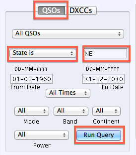

You should use the search options provided in the Search Window. I marked the relevant settings:
